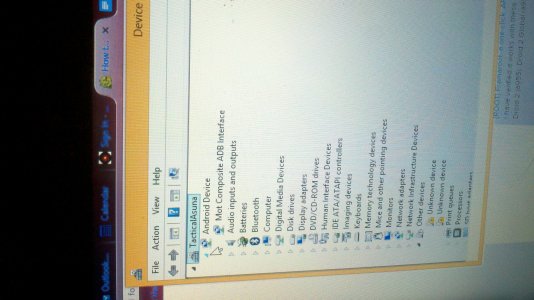

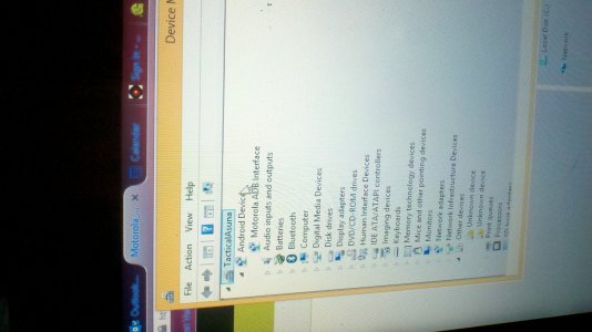

Did you check device manager?
Windows version?

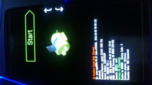

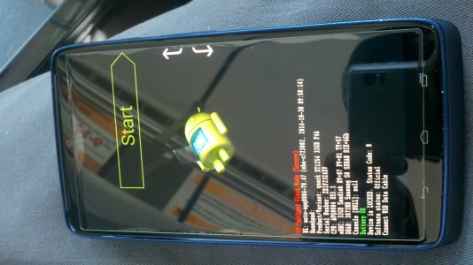

P.S. None of these worked at all and my phone is still stuck in ap fastboot.
This is my phone ap fastboot screen.
Does AP Fastboot's 'connect usb data cable' change when connected to pc?
