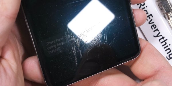

This picture isn't of my phone, but it's pretty analogous to mine in terms of depth and length:

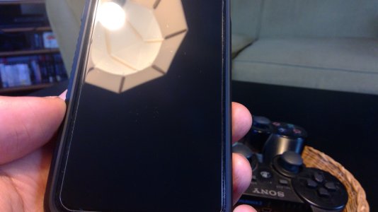

This is mine now:

The "repaired" picture light angle isn't the same as the "damaged" picture. Too hard to tell
Not only is it not the same angle, it's not the same phone!
I didn't take any before shots, so I went online to find a picture of similar scratches. The one I posted is from JerryRigEverything, and looks very much like the ones on mine.

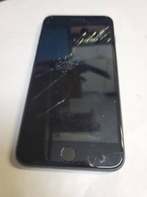

Never tried , so can't comment, I do have older phones with cracked screens cantry and experiment .
My iphone 8+ just needs a screen
I dont think it'll have the same effect on cracks :P
