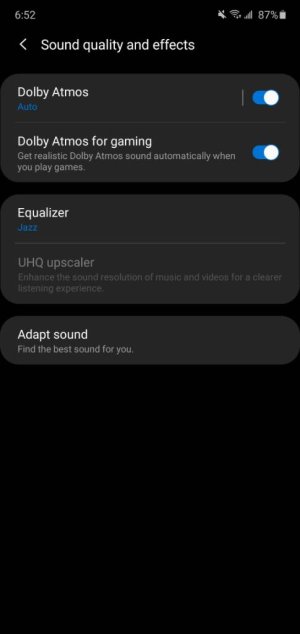

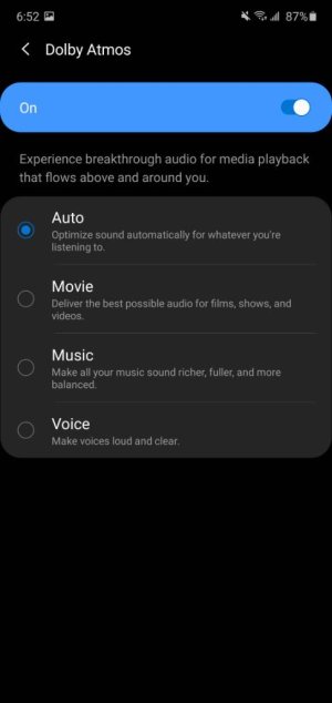

This menu I'm referring to , my fist screen shot , not my 2nd Screenshot_20200529-185300_SoundAlive.jpegScreenshot_20200529-185253_SoundAlive.jpeg
