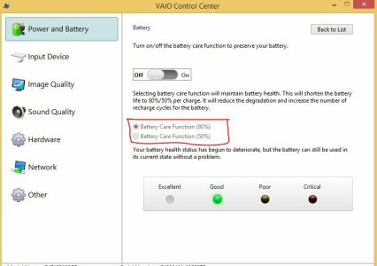

My laptop, a Sony VAIO came with these settings:
And my best guess is that the best way to take care of your battery is to not let it charge to a 100%(as VAIO says) and not let it fall below 40%(as some people here say).
My phone has a non removable battery and I want to last it for long. Suggestions?
