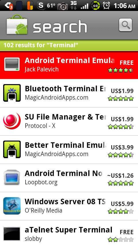

  • A Terminal emulator program. There are some in the Android Market, just do a search. I have tested with Better Terminal Emulator Pro and Android Terminal Emulator.
