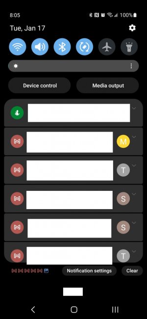

Getting back to this, this issue has arisen more than once since my last post. I've found that clearing the gmail cache makes it go away, but it can return again in the future. It is interesting to note that on one occasion, it was even visible that there were multiple notifications from gmail in the notification status bar (only actually saw this once).
