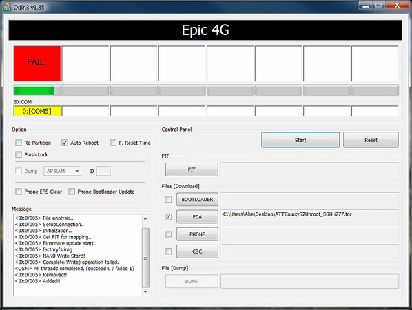

Here's what I get:
But... my Kies does not connect either...
Had to disconnect phone and now shows "Firware upgrade encountered an issue. Please select recovery mode in Kies & try again."
I am plugging it in and retrying the Odin...
Edit: Now shows Pass! OK, rebooting and looks good so far...!
OK... booted up!
You know, the other thing I did this time was to remove my 16GB RiData MicroSDHC card... (for what its worth).

Here's what I get:
Click to view quoted image
OK... booted up!
Your screen says "Epic 4G" - the files are for an AT&T SGH-I777, not for ANY other device.
