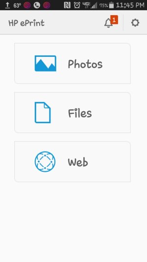

I've got the answer :) Broke down and called tech support today. Hopefully during set up you connected your printer with your router. Is the blue light to the left of the screen on? When you touch the wireless icon at the bottom of the screen do you get a wireless summary that shows your printer has an IP address, network name, etc? Mine was all set like it should be. You also need to install the app HP e-print from the play store. I had done that as well, but still couldn't get it to work. Here's where I messed up. You have to use the HP e-print app. Click on Photos, files or Web, pull up what you want to send to the printer, THEN bring your phone to the NFC icon on the front of the printer.

My network is okay, as other wireless hardware prints, so I'll play with the HP e-print app a little more.
I've been updating the HP Print Service Plugin, but haven't been in the e-print app for a while.
That's probably where my misstep is. Also, thanks for the wifi reminder, I tend to leave it off, cause I've been avoiding Lollypop.
