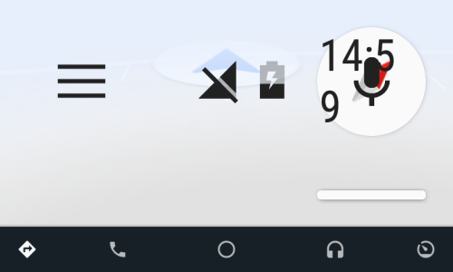

Android Auto works fine (Spotify, etc.), except for navigation with Google Maps. When I enter the navigation screen, I get this:
As you can see, this is a very much enlarged version of the map (I can't zoom out) with battery status and time displayed in huge letters. This makes navigation totally unusable. Has anybody else encountered this problem? Does anyone know a way to fix it?

I had prevously tried re-installing both Maps and Android Auto, but I did it again now, as suggested by a friend, uninstalled BOTH at the same time and then re-installed (first Maps, then Auto) and now it's working properly again. Hooray! :-)
Thanks, I was having the exact same issue with my wife's HTC 10 and our new VW Tiguan.... and this solved the problem!
Thx Andischatz. Had same issue with my HTC10 and Seat. Did as you suggested which was suggested by your friend. Boom. ✌ Any idea how to get Waze working on AA? I've read it's possible, but could not find the app on AA.
