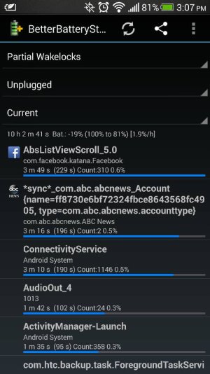

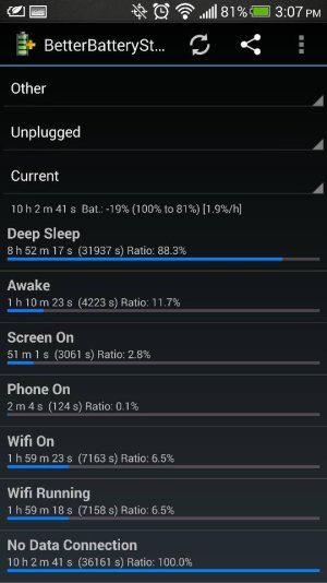

The only thing I have on is WiFi no mobile data etc... why is my battery drain per hour so high? I have dropbox syncing disabled.

For me if I'm using my phone in a normal way just doing what I do checking email, surfing the web, FB, etc. (wifi on, location on, bluetooth on, auto-brightness) I see 3-5% drain per hour. If I try to limit my use then I can get it under 3%/hour pretty easily. If I turn on HTC's power save mode then it goes down to around 1%/hour.
Re: Battery draining?
How long does your battery last with wifi/ mobile data with location services on, before you have to recharge your phone? Also when you say it goes down to 1%/hour with HTC power saver on, do you also have everything turned off (WiFi,GPS,Bluetooth etc...)? Also what is a normal awake % in the wakelock detector app without worrying about battery drain?
I don't drain my battery down every time so I don't measure how long it lasts. I charge it when I'm near an outlet unless I'm going to be traveling and away from an outlet. Otherwise I just use it normally. So from that point of view it really doesn't matter to me how long it lasts. Outlets are common enough that I can always find one when needed.
If I'm using the HTC power saver it's because I'm traveling and won't be near an outlet for a long time. In those cases I'm usually doing some aggressive power management and might go to airplane mode when I know I don't need to use the phone (like when I'm actually on an airplane or driving).
The wakelocks are not an exact science. The wakelocks that are a problem are the ones that are waking your phone up when they shouldn't be. Other ones are normal and your phone does need to wake up sometimes to receive messages, pull information for widgets, use the cell radio etc.
You're already running at a drain of 1.9%/hour. You aren't going to get a lot better than that unless you just don't use the phone, but you didn't buy it to not use it. It's just a phone, plug it in and charge it. It's not an old NiCad battery and you don't need to run it down each time. If you regularly aren't near an outlet for extended periods of time then get a portable power source like the Eton Boost Turbine or Morphie Juice Pack.
