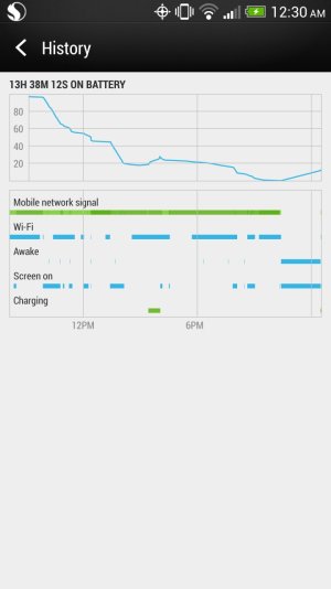

Post a screenshot of the actual battery stats screens. These numbers you posted really don't matter unless we have context such as screen-on time and mobile network signal strength. You could be going through some low-signal areas and the phone is murdering battery while trying to stay connected.
Also app-killers are the worst thing you can do for Android, and end up hurting battery. The app-killer will end up in a tug of war with the apps it's trying to kill, as the apps will keep trying to re-assert themselves and hang out in their natural suspended state in RAM. App-killing may have played a role back in the Froyo/Gingerbread days where phones had 512MB RAM or less but ever since ICS it's best to let Android manage that aspect of operation.

I agree with Jrocker get rid of the task killer, that alone may be killing your battery. As for the battery app, while it won't try to predict what you have power for, the built in battery display will tell you a percentage of battery left. You can find it under settings>power>show battery level. This I think would be of more use to you than trying to figure out what you can, maybe, do and it will use far less resources I'm sure. I also agree with projektorboy, if you think your not getting a good life out of your battery post an end of day screen shot of your usage. Settings>power>history then press and hold the power button and press the home button. Being that you had only had the phone for a few days when you posted this have seen any improvement after a few charging cycles? I also recommend that you not run your device until it turns its self off. I did this just a few times and noticed my battery life shorten. I heard, after I'd done it of course, that it's not good for the battery. Since the last time I did it my battery usage seems to have improved, but it has taken several charging cycles, and I still don't feel it is the best it's been.

Hi all, thanks for the feedback,
Here is a screenshot of my usage, as you can see I ran out of battery late in the day, even with getting some charge time. I have uninstalled the app killer, hopefully that will help with some battery life. I have also installed the Snapdragon battery app, I guess it seems to be helping, the attached screenshot was when it was running 24/7. Everywhere I am (School, work, house) has great wi-fi, 4G, and radio reception so I'm fairly certain my battery problems aren't coming from my phone struggling to connect with any of those services. I've had the phone for about 3 weeks and the battery has had many full charge cycles. I am conservative when it comes to screen brightness, and auto is usually the brightest I ever have it set to. Just wondering if this is normal battery life in the HTC One or I could tweak some settings still.

I doubt the Easy Battery Saver is draining your battery, i use that app myself and have never had any issues with battery drain.
Have you updated or downloaded any new apps lately?
