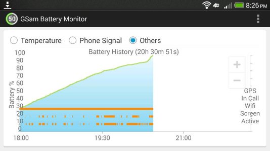

I'm trying to understand this bug, as you can see my charge chart is pretty normal until 90% where it shoots up. This must mean that the software is just saying the phone is charged when in reality its not, so taking it off the charger right after it reaches 100 would cause it to quickly drop back to the low 90s.. If the chart were right it would be a nice slow trickle charge to 100. So in other words the phone is lying for whatever reason.
Sent from my HTC One using AC Forums mobile app
