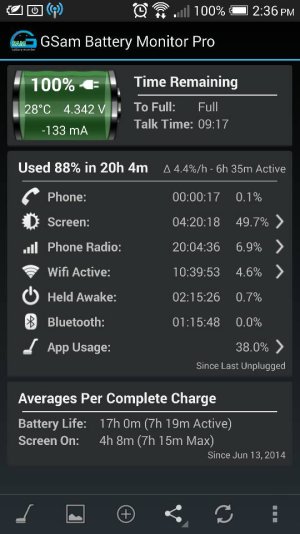

My battery was pretty mediocre. I would get on average 12 hours a day and 4 hours screen time. I ended up doing a hard reset and then a battery calibration using power / volume button cycle and I can't belive how much better my battery is. I am averaging 17 hours a day now and can get 7 hours screen on time in a 13 hour day. The biggest difference now is before the battery would drain slowly from 100 % to about 60% but then really accelerate after that and drain quickly. Now it is a pretty even distribution all the way through the cycle.
