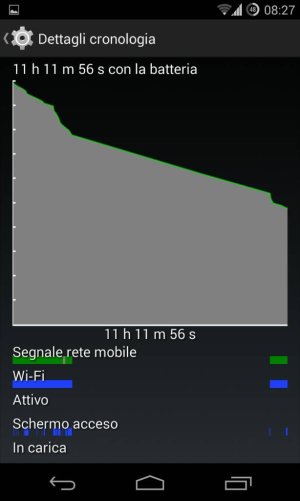

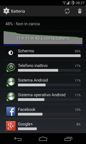

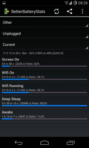

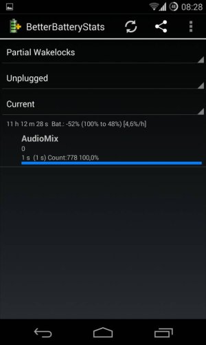

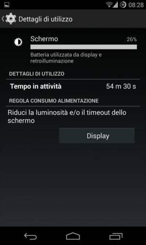

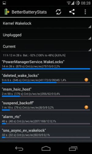

Could you post battery stats when the battery gets low? It will make it easier to troubleshoot when we can see what is going on.
These are screenshots of last night... battery drop from 78 to 50%uploadfromtaptalk1391585757547.jpguploadfromtaptalk1391585777890.jpguploadfromtaptalk1391585794809.jpguploadfromtaptalk1391585814200.jpguploadfromtaptalk1391585836380.jpguploadfromtaptalk1391585848750.jpg
