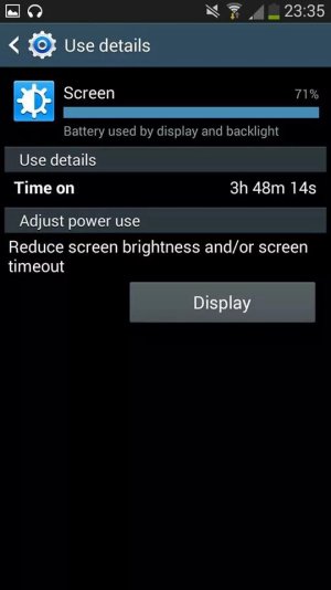

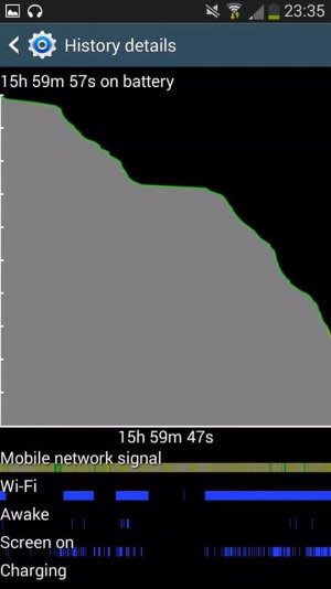

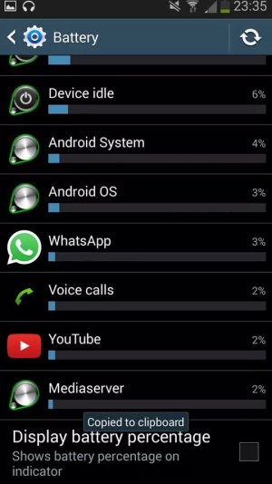

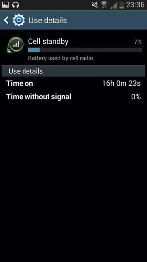

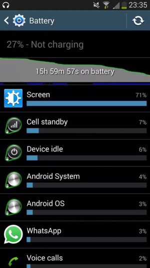

Charge up to 100%, then let it drain to 20-30% with normal usage, without charging in between. Then show us:
1. The main Settings>Battery screen.
2. The fullscreen battery graph screen (which shows Awake time and Cell Signal Strength).
3. The Screen category (to see total Screen On time).
4. The Cell Standby category, if present (to see Time Without Signal).
http://forums.androidcentral.com/am...ide-how-post-screenshots-android-central.html
To be honest with you the battery lasted waaay longer than I expected. Also...mobile data and wifi (depens if I was home or not) were on all the time. Here are the screenshots.
What do you think about them?
Best regards!
That's not too bad. Given the remaining battery left, one could extrapolate that you're on track for 5 hrs 24 min of total screen on time, which is pretty normal, I think. Other people with an S3 can weigh in here, because I don't have direct experience--but it sound about right.

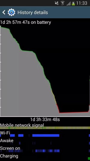

Let's say it is on 12% and the charger is plugged in. If I let it that way for let's say...10 minutes...it will charge for eg up to 15%....BUT...If I close the device...and let the boot animation with the battery that is charging appear....it seems to be charged around 40%. If I start the device...the battery percentage will actually say I am on 40%. Why is this thing happening?
Here is a photo:
If you are looking at the graph...you can see how it jumps. I know it's hard to see...but I think it will be better if you click on the photo.
Any ideeas why this is happening?
Best regards!
Are you completely powering off the phone when it jumps up, or are you just putting it to sleep? Devices generally won't charge as fast if the screen is on and you're actively using it. They will charge faster when the screen is off, or if the device is completely powered off.
So..it is on 12% and then I am completly powering off the phone. The icon with the charging battery appears...and the green part (which shows how much it is charged) isn't at a low lever...which should mean 12%...it is at something around half. If I immediately power on the phone, the percentage will be the one the battery represented earlier (around half) and not 12% anymore...ast time it was at 40% or so.
You can try recalibrating the battery meter by letting the phone drain until it shuts off automatically, then plug it in to a wall outlet and let it charge up while powered off for about 4-6 hours, until it's at 100%. Then use it until it shuts off automatically again, and repeat the process. Do it maybe 3 times. See if it becomes more accurate.
