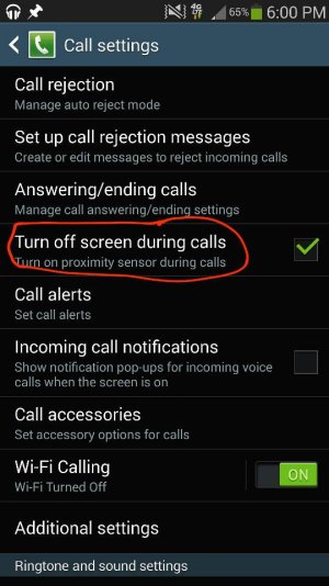

Do you have the proximity sensor on?
Sent from my T-Mobile Note 3 using AC Forums.
It basically is a setting under the phone. What the proximity sensor does is turn the screen off when you hold the phone near your face.. And turns it back on once you remove it from your face.

I had it turned on, and just now turned if off.. I hope it helps :P
Turning it on will make things much worse - that's not the answer. Now the screen will NOT shut off when in proximity of your face. That will cause all sorts of other issues.
So we understand, during a phone call, you have the phone up against your face; you then want to hang up - but when the phone is pulled away from your face, it doesn't light up the screen? How fast does it light up once you hit the Home button?
What he said ^. You want that setting ON.
Sent from my SM-N900V using Tapatalk
Same problem as mine.. It is frustrating. Broken proximity sensor (for me). I leave it off, then just press power to talk once connected (eg so my face doesn't press the screen). When I'm done I press power to turn the screen back on. Kind of a pain but I can control the phone that way .. Could exchange it but I don't feel like it (and factory reset first) , so I deal with it that way. If I leave it on, I get the same thing you do which is maddening because you have to wait for the other party to disconnect before you can get control of your phone back (and if they don't hang up, you are stuck).
