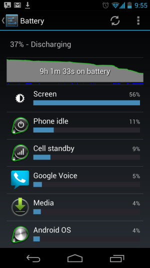

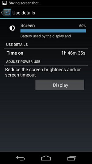

So Yes my screen was on for Over a hour but 5 hours really, on the extended battery? This is the worst I have ever gotten. I flashed back to stock from aokp because I was getting about 7 hours battery life. Now on stock jelly bean I get 5 hours? I was on an older rom that was jelly bean and I used to get 14 hours. What am I doing wrong here? Screen is on auto brightness, don't have any widgets, running nova launcher. Gps is turned off, bluetooth also off. ???
I would suggest turning Google Now off. Once I did that I started seeing a huge improvement.
It's in Google Now>Settings>Google Now>and there's an On/Off toggle at the top. Also it's usually recommended to leave auto brightness off. I hope I was able to help a bit! :)
One thing I noticed in your screen shot was your wi-fi. Were you in one place this whole time? Maybe turn off your wi-fi when you know that you won't be using it. It looks like it was often searching for networks.
I usually hit 8/9 hours at about 25-30% (extended battery, too). That's when I plug it in for the drive home. It does seem like JB has started using more juice than ICS. Google Now seems a likely culprit, but I like having it handy, so I keep a charging cable handy.
In addition to wifi OFF when not needed, I leave OFF Bluetooth, and have brightness set to 50%.
Let us know your progress.
TJH
Do you use automatic brightness by chance? I was using it all the time in ICS, but with jellybean I was getting terrible battery life too. I noticed that the screen seemed brighter than usual with the automatic brightness checked, so I turned it off and set the brightness to 50% or lower. My battery life is back to normal. Seems like automatic brightness may be set too high in jellybean.
That's not too bad.. I can't get 2 hours of screen time. I'm on auto-brightness and usually indoors.
I'm a little confused? Where in the screenshot do you see an indication he had the WIFi on at all?
This should be in the battery life thread. I was having the same issues, now it seems to be a bit better. I didn't do anything but install OS monitor. Do you have light flow? It doesn't really work with JB yet, and I'm wondering if it is creating an issue.
So today I read the thread and I took auto brightness off, and put it at 50% brightness. Granted the phone was on stand by most of the day, because I was at work. So I have a 1h and 7m's screen on time.Still the screen is eating up so much of my battery as well as Cell Standby. Jelly bean just seems to eat batteries. No I don't use light flow. Any other ideas I haven't turned off google now, but wouldn't that show under battery statistics if it was being used?

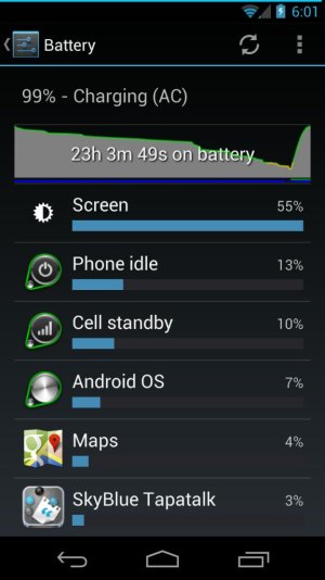

Best battery life I've ever seen
Got down to 17% at 22 hours, made my day.
