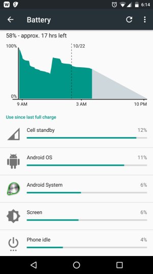

Something is definitely waking my phone up which is preventing Doze from kicking in. I thought Doze was supposed to ignore wakelocks. Here are 2 screenshots immediately after I woke up this morning.
OK... looking at that, I think I see one spot where Doze fired off... around 3am. See that big hole in the awake time? That looks like Doze. As for earlier.. is the phone off, just sitting on a table? They were fairly conservative with Doze settings, so the phone has to be still for a good 30m to an hour.

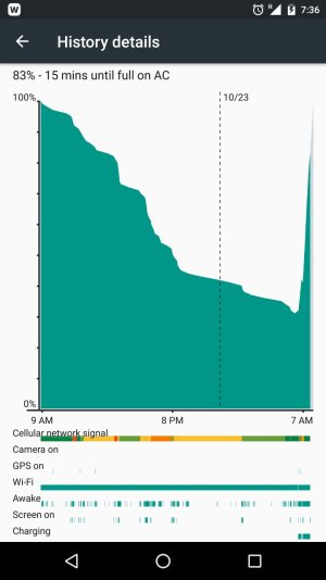

I had one, a weather app. Weather Timeline but I disabled it after reading this message. Last night I went to bed with like 43%, woke up with 33%. I'm talking my phone is sitting doing nothing, on my nightside stand for like 8-9 hrs. I'm purposely not touching my phone very often throughout the day to see if it kicks in..
You can see my phone seems to be turning on a ton of times between when I went to bed at 8PM and woke up at 5:30-ish.
Yeah... there's something running amok there... there's a lot of wake ups piled up on there a bit after midnight. Hard to tell what is going on without looking at your phone.

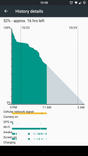

this is what it should look like:
I zonked out on my couch like 11 or so... You see a few wake ups in a regular interval, then a longer pause... that's a few maintainence windows then Doze starts to lengthen the time between windows. I woke up and checked a few things then finally went to bed.
