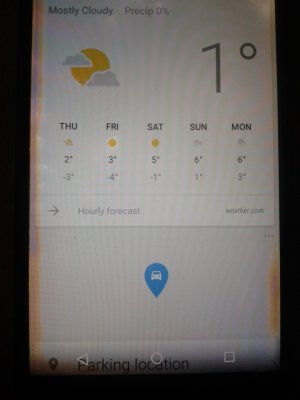

I dropped recently my Nexus 4 in the toilet (ew i know) it was fully underwater for 3 seconds. I took it out, dried it with a towel, and pressed the power button to turn the screen on, so it worked for like 5 seconds then it went off. After 10 minutes i disassembled it , (took only battery away), and gave it a 96% alcohol bath, for 1 minute or so. I went to school and my phone stood 11-12 hours in rice till i came home, then i disassembkled it completely , camera and speaker off and everything, dried it with a paper towel and let it dry in my room over night (9 hours), After that i assembled it and it turned on right away, but i have strange colors on my screen now, on the border of the screen. The touchscreen also doesn't work properly, i must press 10 times till i reach the menu (btw i have lollipop), and it also works alone, i may not press nothing, but the telephone app opens itself and calls random people. I think the touchscreen is scrwed up. I think it either from the alcohol, or from water (water still inside - between the toch screen and glass screen.) But i think the alcohol problem sounds more logical. I also have some photos of the screen.
Please help, i wouldn't want to buy a new touchscreen, maybe there's water inside or i don't know, but if there's no option left, i'll buy a new touchscreen.
Thank you!
EDIT:P.S: The colors got brighter and brighter...
Photo1: You can see the light orange stripes on the edge of the screen and also strange white point which seem to be "deep" in the screen

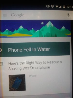

Photo2:20150205_171131 (768x1024).jpg
The purpose of the alcohol is to remove the water, and hopefully the impurities in it. Several changes of alcohol are recommended, with agitation in each case. Read Rukbat's article:
http://forums.androidcentral.com/am...ow-s/477140-guide-oh-no-my-phone-got-wet.html
I imagine there is still water in there. In your position I would give more alcohol baths. I hope you get it to work.
well, no. Alcohol baths are bad. BAD!
My screen is now in a worse situation because of the more alcohol baths i gave it.
