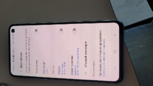

Are you sure you don't have Do Not Disturb active on any device? And if you go to Settings/Notifications/App Notifications the apps you're having issues with are set to allow Pop-up?

And I do not have do not disturb active

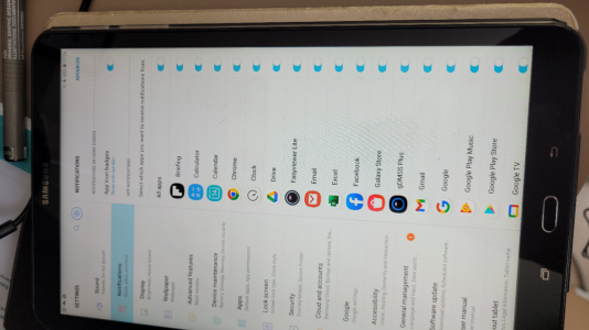

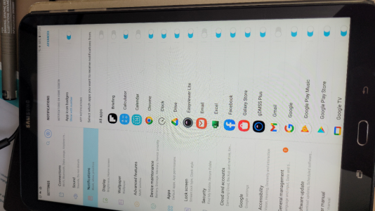

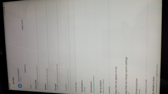

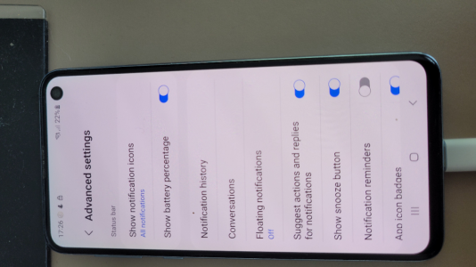

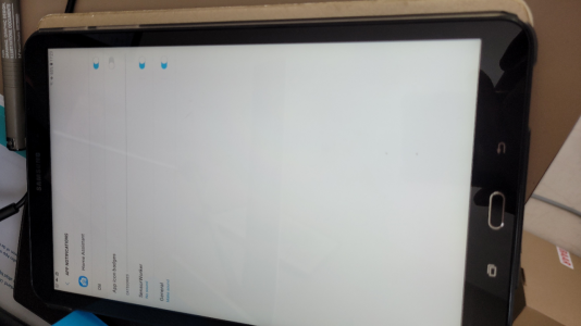

I wil add some images THe first is frm my tablet, the other from my S10
Welcome to Android Central! You've also looked for an option to "Pop on screen" in the Settings>Apps menu, after selecting the app in question and then going to the Notifications section? Make sure to tap the words of the notification category in question, not the toggle switch.
Thanks for the welcome,

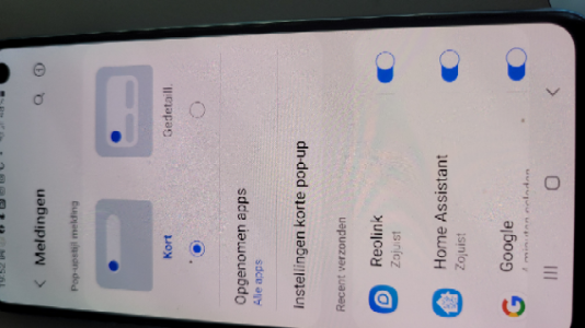

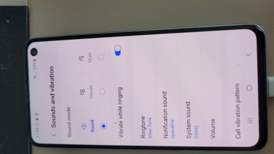

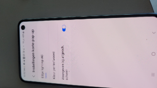

I uploaded some images of the settings
As fa as I can see they should be OK?

No on the desktop it wouldn't be issue on device also make sure no app cleaner's, Malwarebytes , AD guards they can be problem for app notifications

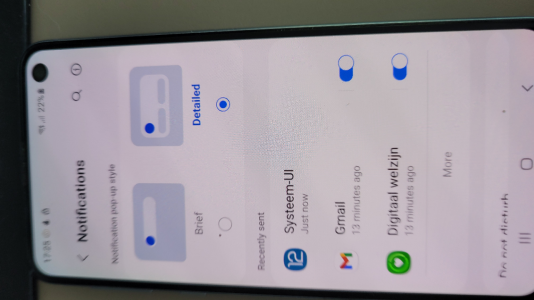

Ahh sorry, I must make new pics while language is set to englisch and a better resolution I did not realize this was hard to read.
I made some new pics Part from my S10 and part pf my samsung TabA
I hope thist will give a better picture, and I heve set the language to English

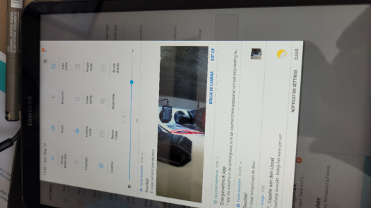

AlsoI added an image what I see when I swipe down on my tablet.
This is what I expect to see as popup on a notification.

In the Notification Pop-up Style menu, try also selecting Brief, and then select Detailed again, to see if toggling it triggers anything.
On the Home App notification settings, when you tap on any of the categories (not just to turn the toggle on/off), are THOSE set to pop-up?
Thanks 👍 all also @mustang7757 and @B.Diddy , now I finally get something that i canwork with:) This did the trick for the S10 and I got it working on the S20FE
I even got a separate notofocation sound working for it.
