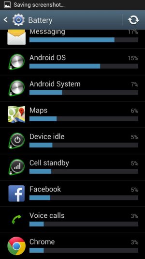

My S3 would fully charge but as soon as I disconnect from charger it drops down to 98% after 5minutes of use it would be down to 89% what is draining my battery so fast?

We need some screen shots of your battery monitor screen.
I also have power saver enabled.
