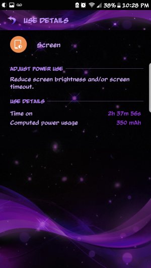

If you're consistently trying to get six hours of screen time, the phone is going to run hot, especially if the screen is on for long periods (long games, movies, etc). The screen is the biggest single power draw on the device. The S7 Edge has a liquid-filled cooling coil inside the case. When the device gets warm, that's the cooling coil discharging the heat that it's drawing from the components. Having said that, I think that the phone routinely running that warm would concern me too.

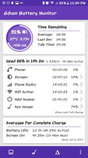

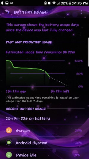

If you have insurance or an extended warranty, you're in pretty good shape. And 52% after 17 hours is just fine.

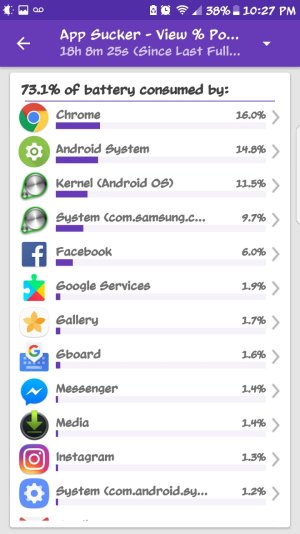

I think you're in good shape. Just use the phone as you want and see how it goes. I don't see anything that would make me worry about the battery.
There is apparently something still bothering you about this, but I don't see anything that would substantially concern me.

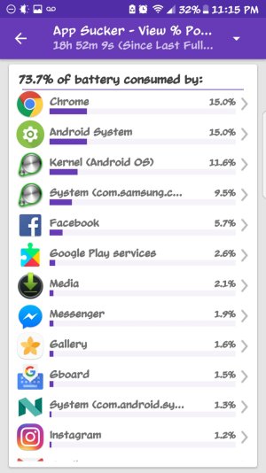

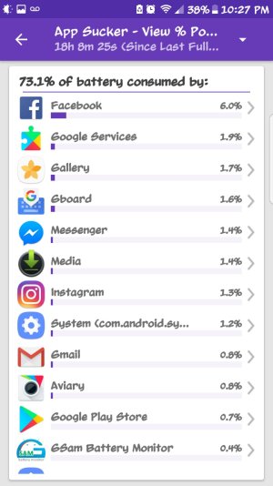

If that was my phone, the only thing that stands out would be the Facebook app. That's known to be a resource hog. It doesn't look bad right now, but I've seen it be somewhat unpredictable. If I used FB, I'd dump the app and use their mobile site in the browser.
About your browser, some folks claim that the Samsung browser is better on resources than Chrome. You can use an ad blocker with the Samsung browser too. I use it for the ad blocker. There's a plug in for Chrome on the PC that will sync your bookmarks and such with the Samsung browser too.

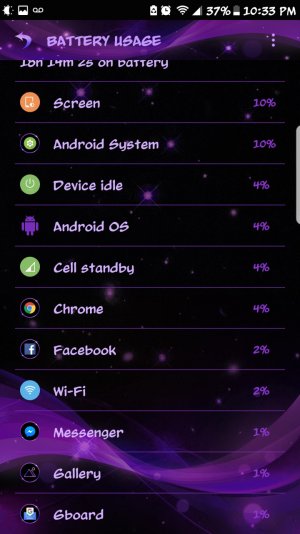

7. The battery drop from 78 to 68 in 38 minutes (16% discharge rate) isn't all that bad, considering all that you did with the phone. It's very likely that the screen was on the whole time. Remember that the screen is your biggest battery hog.
8. Why keep track of all that (signal level, wakelocks, temp, etc)? I also use Gsam and Wakelock Detector to monitor those things. But I normally don't look at them unless I'm experiencing an issue. It's easy to get wrapped around the axle over little changes in this value or that. Give yourself a break. For example, you say that you live in a good signal area. So why constantly monitor network signal? If you experience network connection issues then check it. Otherwise, forget about it. You monitor wakelocks. Wakelocks aren't necessarily bad. Again, leave them alone unless you have an issue.
