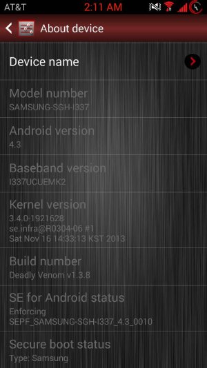

Yea sorry I wish mine was unlocked :( loki dont work past 4.3 and kit kat so im safe strapped (wasnt even going to get into that) ok man I reccomend cwm after you root the rest still does apply about the backup make sure you save it to the extsd so you wont accidently delete it and be romless and loose everything use a program called titanium backup to backup all of your apps and call log and sms restore for the rest you might want to get a 32 or 64 gig sd card it makes it a lot easier :) store your rom you want to flash on your extsd and after your full wipe select it from the list flash it and boom also always check your md5 sums

I need this information settings> more> about device its going to be twards the bottom
