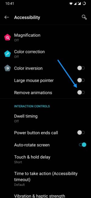

Do you mean the bolt animation when starting fast charge? This only happens on the lock screen and I don't think disabling Google apps could interfere. Have you disabled the animations in the Developer Options? Which unlock method are you using?
Also, go to the accessibility settings and make sure this option is not enabled.

This wasn't selected, also I'm not on actual 35 watt charger, but tried it on standard charger with phone in sleep, still no Bolt animation, I use fingerprint as usual,
