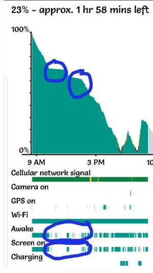

I totally agree with the guy up above who said something is keeping your phone awake. I was using the blackberry hub, and my phone was awake at all times, even though everything was on manual refresh, and it took a big chunk or if my battery.
I'm including an example that shows my phone actually testing now when the screen is off. The two circles show on top show relatively flat lines when the screen is off, and the circles below show the screen was off and the phone was not awake. You probably have a bad app or setting that is causing party of your problem.
