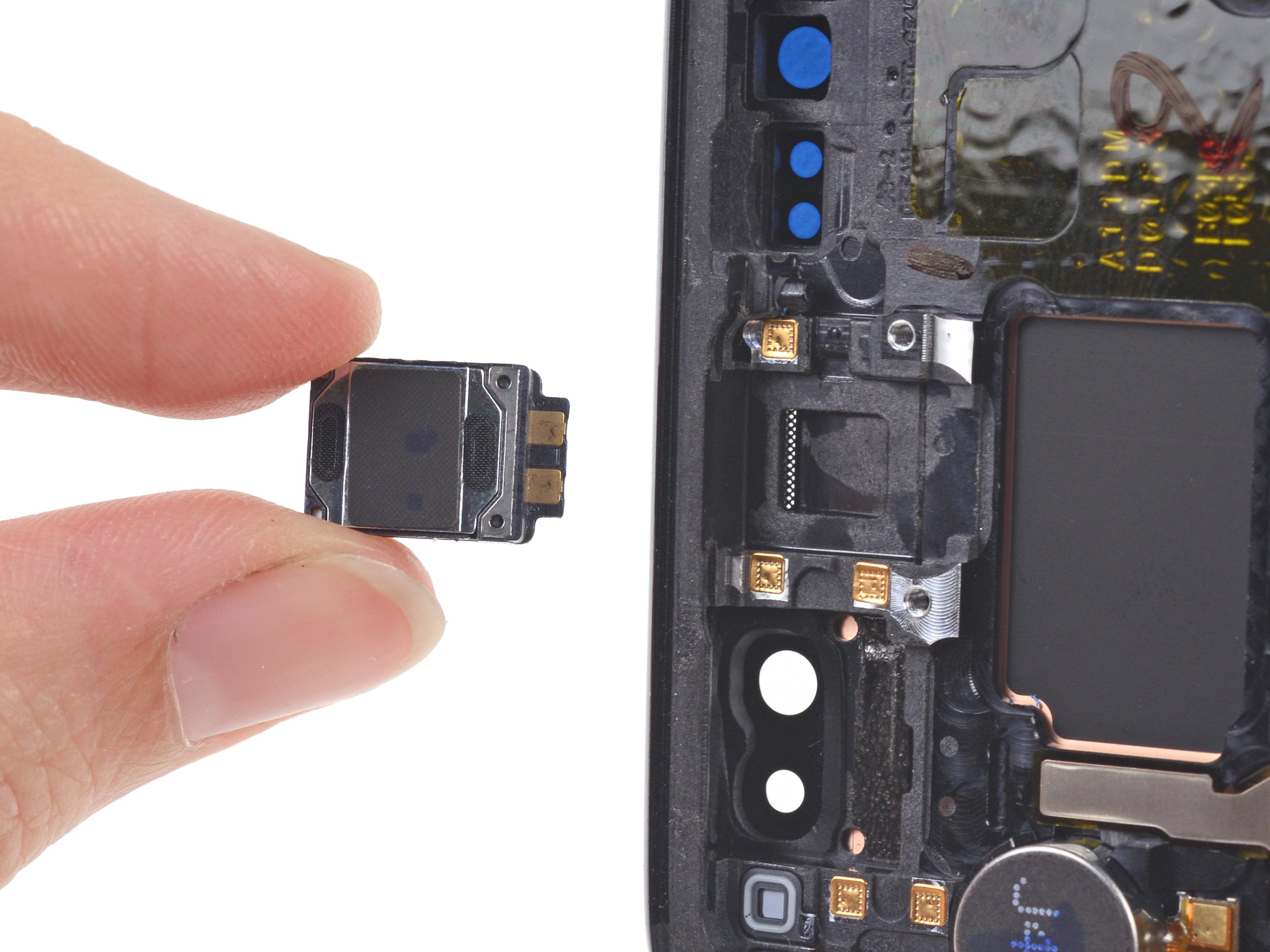

Found a video on locating the speaker (on a much newer device). I didn't even know it was a different physical speaker. Just found mine. Cleaned it. no change. :mad:
The in call you tried turning the volume up while on call sometimes the volume controls the media not the volume
omg just saw another video about cleaning. Take the phone apart and remove the speaker and clean the area around it. Yikes! It was for an S8 Plus. I don't think that's in my comfort zone.
Maybe a simple thing for a reputable phone repair place?

I would try with a toothbrush I remember the s8 and s9 series were prone to build up in the upper speakers then use a can of compressed air
