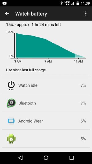

Yesterday my 360 ended a 12 workday with 40% remaining, ambient mode on and off and a normal amount of interaction.
Today at 7 hours I got the 15% warning and shortly thereafter the thing was toast. The battery graph shows a distinct turn downward for some reason, leading to the shortened day.
I've seen this before with Facer but today was a stock face. Any ideas?

I'm having the same. My idle was 12% and screen seemed high at 28% and hadn't been on much so I'm doing a rest to see if that helps.
Press the graph when that happens and post the next page. Something happened at the "knee" of the curve - something woke the watch and kept it awake, the battery developed a pretty bad dendrite, something. The page you posted shows overall use since the last charge, it doesn't show minute-by-minute use, which is what we need to see.
BTW, 40% is good - so you can charge it at that point. You shouldn't let it get lower. That one 15% hit won't do much life-shortening, but doing it consistently will. I'd set the warning at about 40% if you want to be conservative (that's a warning to finish up your work and charge or shut off the watch), or 35%, which is a warning to grab for the power switch.
Say what? Are you talking about the Watch Battery graph pictured in the OP? When I press on that graph on my phone in the Android Wear app, it doesn't switch to a minute-by-minute graph. Am I missing something?
Thanks for the tip about batteries. Clicking on the graph doesn't enlarge it the way the phone's battery graph will. I guess I just have to keep tabs on what might be causing the downturn in the future.

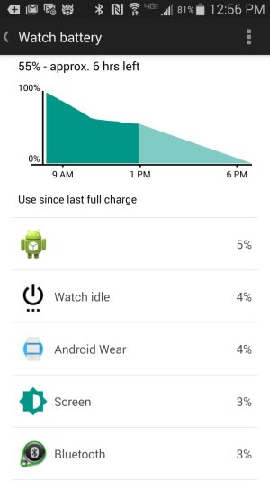

I also have a problem with inconsistent battery life, most days it makes it to the end of the day with around 60% left but some days it goes down very very fast. (like sometimes before noon). I don't stream music on it, I don't really do anything with the watch that I think would adversely effect it. I only have 2 custom watch faces on it and no other watch apps I have tried uninstalling them and it still does it. If I notice it's going down fast (like I did this morning) if I reset the watch then it goes down at a normal rate. Notice on my chart below, the discharge slowed way down once I restarted it at like 10 AM. I have a stock Verizon Galaxy Note 4 for my smartphone. I thought it was a defective watch so I had Motorola replace it and the charger under warranty (which they did without much trouble) but the replacement watch acts exactly the same, so I think it's something the phone is doing.. Does anyone else have this problem? :(
