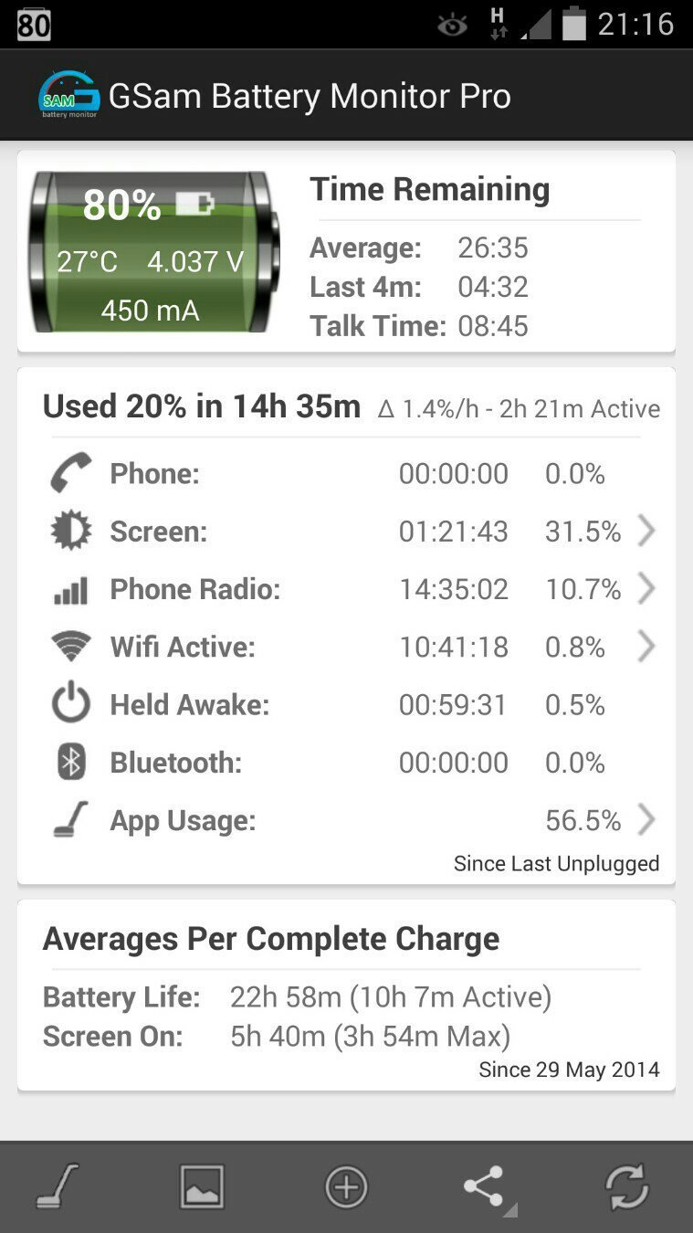

Try installing GSam battery monitor, and it will show you in the battery image, how hot it is and how fast it is charging.

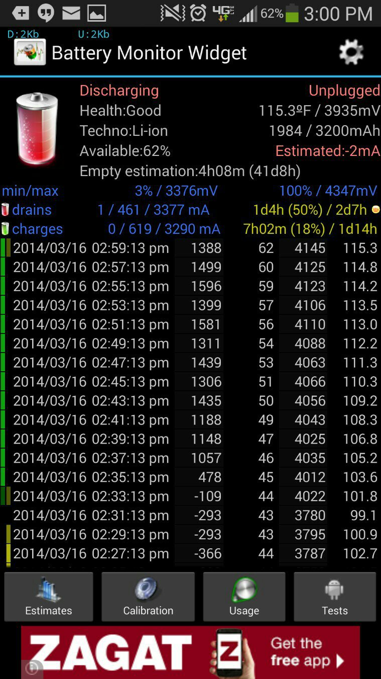

Sounds like a charger or cable problem. Use battery monitor widget to see charging rate. With the stock 2a charger, it should show close to 2000ma. Graph for example only, yours should show higher
