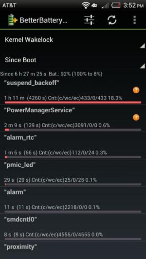

Hi MangoPowah. Sorry I didn't make it clear. Both occurrences of the instant drain happened very early in the morning (this time 5:25 am) when it was not charging. It was just sitting idle with screen/wifi/data/recent-apps off on my nightstand.
I just installed BetterBatteryStats and what should I expect to see if some rogue apps are running in the background draining my battery? Thanks!

You might look into a different weather app. Several people have suggested that the Sense Weather/clock goes ape if it can't figure out where it is (for whatever reason). It usually shows up as high MAPs usage, because it uses maps to find location. But I don't see any high maps usage in your image.
I've disabled both the App and the Widget in settings, and installed Digital Clock and Weather by droid27.
Your Cell standby looks suspicious. Mine runs at 3%. If the phone body is warm at the top of the back, around camera height, that means excessive radio usage. No clue how you might fix this.

Something along the lines of this would come up.
Sent from my HTC One X using Android Central Forums
