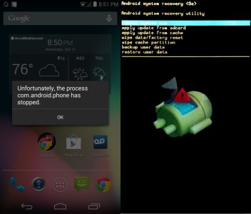

i was told, Unfortunately The Process Com.Android.Phone Has Stopped Error was a phone hardware issue, not software, is this really true? The phone needs to be replaced, the error can't be fixed. Is this an up-sell technique or true statement. My phone now doesn't work at all because of constant error message dialog box. Sprint rep said the Sharp Aquos Crystal model is the problem, not android software. Sprint personnel told me this, to buy another phone was the only option after a hard factory reset was performed (5) times and didn't remove the message from every screen. The phone was reset and apps reinstalled brand new, however the error message remains an wont let you move past any screen.
The main problem is once the device boots up you can see everything behind the error dialog box (new), however clicking anything is virtually impossible. The error reappears instantly not allowing for any input. Even the back arrow home icon and open apps are not accessible. Trying to speed tap the error message dialog box is pointless. I did tried about 30 - 50 taps to work around and it worked but took 20 minutes to reach settings menu.

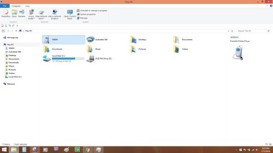

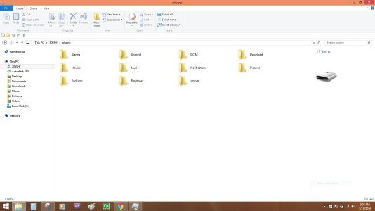

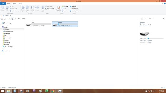

I thought android meant software not hardware. Phone can be accessed by a laptop via USB cable and all looks file folders look ok. Nothing appears to be missing. Sprint was told the hard factory reset did not work to remove error message, they immediately suggested buying a new phone. This particular model has trouble and will fail again even if repaired. Google would seemingly be able to correct this, told otherwise by Sprint today...
These are the steps tried; factory data reset in Recovery mode
1. phone was on, turned it off.
2. Press and hold the Volume up button and the Power button at the same time until the device turns on.
3. Press the Volume down button to select "Recovery mode."
4. Use the volume buttons to scroll to "wipe data/factory reset" and press the Power button to select it.
5. Scroll down to "Yes - erase all user data" and press the Power button to select it.
It Erased all of data, restarted with its factory settings. The Welcome screen popped up like the first time. However so did the error message. I reset a total of five times thinking a mistake was made. No mistakes. In speaking with a Sprint rep, he told me almost exclusively the phone model has this problem. sometimes a factory reset works but more than not the phone never works properly again. I spoke with him long enough and gave him enough details to show that i did nothing wrong in the procedures. We then discussed other phone models and mentioned Samsung and a few others have never had this problem. I said well this phone is new first generation he said i know. Then said the only option was to get another phone because he has seen this many times before.

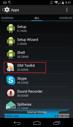

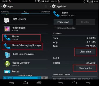

After composing this post and waiting awhile, i noticed the message disappeared. So immediately i went to settings to perform the cache clear and force stop. All i got was a black screen. I restarted the phone and got the error message again. It really didn't work. The Screenshots show the status. The recovery mode image was found online, my recovery mode menu is newer and has a number behind the (3). After numerous taps i got to apps settings, 10 taps to error message, When i reached the phone settings I force stopped and cleared cache. The Sim toolkit was 0.0 because of the new install. Still nothing now only a black screen when tapping any icons.

Many people seem to have good luck in getting rid of the error by clearing cache/data in the "contacts storage" app in settings. Even turning off Automatic time zone cleared this same error on a Karbonn phone... see video at the end of the thread. I can even cause this error to appear on my Note 10.1 2014 tablet by turning off my phone app and contacts storage app (if I recall) using the Debloater program written for Samsung devices.
Have you or Sprint tried starting the phone in Safe mode? If you can successfully get into Safe mode, you might be able to clear cache/data in contacts storage and perhaps the phone/dialer app if possible. Note that some factory resets do not wipe "all" data, so it's possible some data could still be there messing something up.
