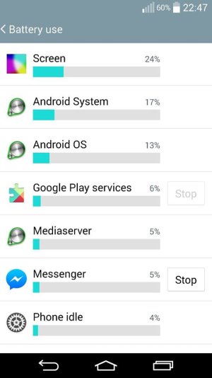

First question: I bought my LG G3 few days ago, is it normal that battery is draining very quick? Every two or three minutes 1% is draining no matter what I'm doing but literally, only time when battery isn't draining that quick is when my phone is locked and I don't use it. Brightness is 22%!!!

Before you consider one of the big batteries that are indeed available for the G3, let's try to understand what problems you may be having with the stock one. A new G3 ought to be giving impressive screen-on time at 22% brightness. Could you use the device normally and before you recharge, post screenshots of the battery usage, and add other info that may be relevant such as location reporting settings, mobile signal strength etc.? Also roughly what you used the device for in that period.

Even when I'm doing somethin in settings it drain really really fast, don't know what is the problem, like I said, 1% per 2 minutes, sometimes even worse, only good thing is that on stand by battery is amazing but only then. I used facebook for few times(now deleted), messenger not often but something like 2 hours, few videos on youtube and some research on chrome. Today I used it maybe for one hour on messenger, and listening music for about 30-40minutes, also when I tried switch to ART it drained for 2-3% when it was loading, and of course when I switched ot back to dalvik again drained 2-3%, really don't know what to do, everything is great about this phone, only battery is miserable, even my lumia 820 had better battery then this LG G3.

Every time when I look at my battery use "android system" is on the top, from 20% to even 40+%, is it possible that maybe some files are corrupted?

Ah, so Android System is normally at the top of the battery usage list. That makes a difference. That's why I suggested posting screenshots of battery stats at the end of a usage cycle, before recharging.

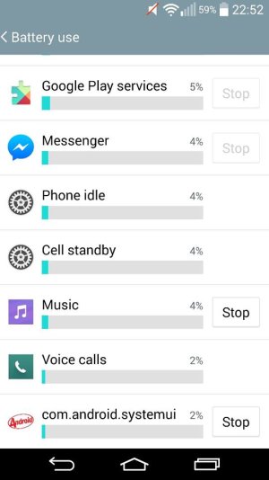

Yesterday and today I had something about 6 hours on screen, Im not expert, is that solid, great? Now left 4% and android OS is 15% and android system is taking 9%, is that ok?
6h SOT, assuming mixed usage, and the 22% screen brightness you quoted in your earlier post, and that everything else is fairly normal, is okay, and the other stats are normal enough. As you're probably aware, routinely discharging to 4% will soon damage the battery, which is why I mentioned the 40% figure above....in fact, I think that the ideal level at which to recharge is 50%, for the best performance and lifespan of the battery.
