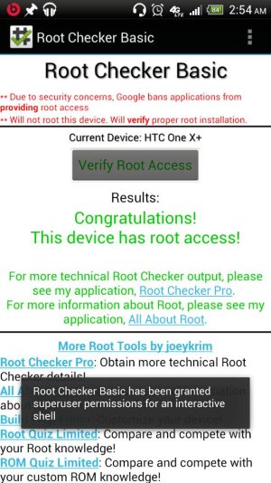

GO DOWN LOAD ROOT CHECKER FAST FREE SIMPLE ;)
Sent from my HTC One X+ using AC Forums mobile app
