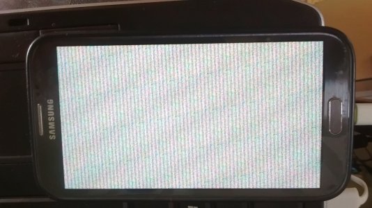

I was charging my Samsung Galaxy Note 2 using a 10,000 mah battery pack and all of a sudden the screen looks like this now.
It was not dropped and the screen is smooth without any scratches.
Is it easy to fix?
thanks
Here's a picture of how it looks now:
More than the digitizer, the display might be busted (or the display driver/circuitry). If you turn off your phone and then on, do you see any clear images at boot or does it always look like that?
If it's the display/driver, however, it's not an 'easy' fix as it does require you to open up the phone and either replace the whole thing or connect loose wires. I'd recommend you to take it to a repair shop for review.

The screen is always like this.
Never see anything when starting up.
As soon as I turn it on, this screen comes on and stays on.
Then yeah, either the display panel got damaged or the display driver did. A repair center can probably test a temporary panel to see if that's the issue or if it's something else.
