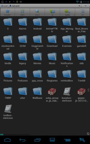

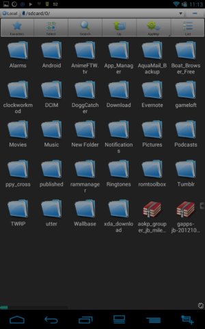

Sorry for triple post, just wanted to add some screen shots to help
Your stuff is located in your '0' folder and you technically have 2 SD cards, copy the stuff you need, then delete the 0 folder as well as the legacy folder
