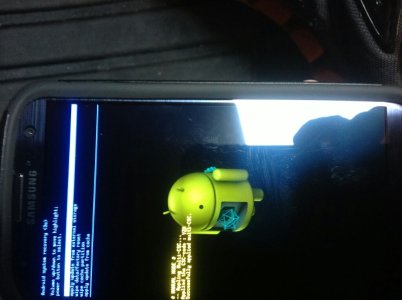

2. I'm not sure what the deal is with my CMW, when I try to boot into it, it takes me to Android Recovery. I was trying to flash the WiFi toggle from an xda thread.
3. I shut the phone off, held vol up + home + power. It takes me to something similar to CWM, but its called android recovery.
I'll snap a pic for you.
Basically every time I want to boot into CWM, I have to flash it right before I reboot into recovery.
Sent from my S3 pip-boy
You don't have CWM installed then. If you are pressing Vol Up, Home and Power at the same time that will bring you to whatever recovery you have on your device (default being Android Recovery if nothing else was installed). Whatever you use to install CWM did not install properly. What did you use to install CWM?

What's odd is if I flash it, the reboot to recovery, it goes to CWM, but if I don't flash it, I go back to stock recovery.
Any tips on getting it to stick or maybe different recovery?

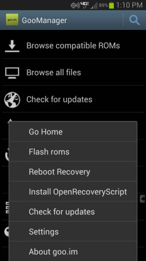

Once you install Goo, open it and then press the Menu button - one of the options is to "Install OpenRecoveryScript" uploadfromtaptalk1368994277203.jpgSent from my rooted, debloated, deodexed Sinclair ZX-80 running CM -0.001 using Tapatalk 2
