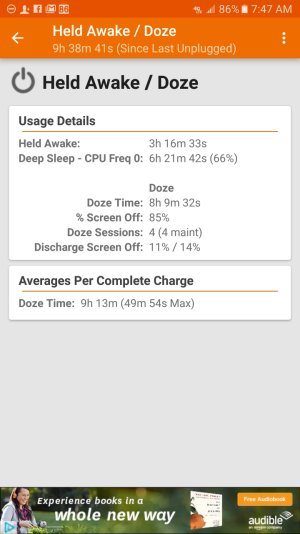

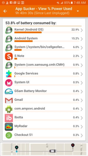

Well, I'm back to being frustrated! After a week of running great overnight, I'm back to losing 15% in about 8-9 hours. I haven't changed anything haven't added any new apps. So not sure what's up. I'm going to install GSAM and hopefully that will give me some answers. I may need to come here and post to help decipher it though. LOL
If anyone is still following this thread, could you look at these screenshots from GSAM. I charged my phone to 100%, then set it down and left it overnight. Once again I had dropped 15% in about 9 hours. I still don't understand why it was great for a few days after my factory reset, and now it's back to this.
