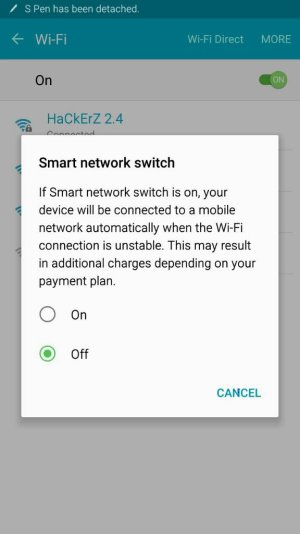

Hmmm....goto Settings> Wifi>More>Smart Network Switch. ..make sure it's off. Then back to More>Advanced. See if you have a Mac and IP Address.

Smart Network Switch is turned off and I verified I have both a MAC address and IP address. My IP address is 192.168.1.122 which matches the subnet of the router. I feel like this is a tough one to solve. It's almost like the DNS settings within the phone are hosed only when connected to wifi. Is there any way to release and renew the IP address or flush DNS like in Windows? I'm shooting out random thoughts since I'm stumped.
