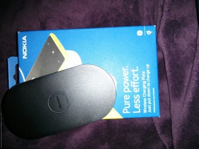

I have personally tried two sperate JBL Power up charging speakers and currently OWN a brand new Nokia wireless charging plate:
I can tell you with absolute certainty that neither the plate or the JBL speakers work.
I'll be returning the Nokia plate the moment I have a chance.
Save yourself the headache and do not buy!
