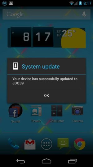

VZW is finally catching us up. Check your Settings- About - Check for Updates.
Just got mine at 8am this morning. Usually it takes me several days before the OTA hits my phone.
