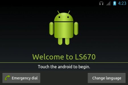

Here's a screenshot of what I get

Re: need 3 experienced testers...
Huh, I never got the setup wizard. Just realized that, although that may be because I never bothered to flash any gapps.
setup wizard is in Gapps...
