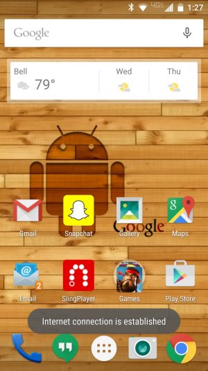

I'm not sure when this started happening, but I'd guess the past few months or so I've noticed it. I constantly get a "internet connection is established" message popping up on my phone when using it, especially when I first wake it up from having it in my pocket.
This happens on both wifi and my cell network. Are the wifi and cell radios just dying on my phone, or was this message added in an HTC update and just fires off everytime there's a slight connection problem?

I found out it was my QNAP video app I use for streaming videos from my NAS. Not sure if there is a setting to remove this annoying info box.
If you have anything that's qnap related in the phone try to uninstall.
Hope this helps, was getting so frustrated with this.
