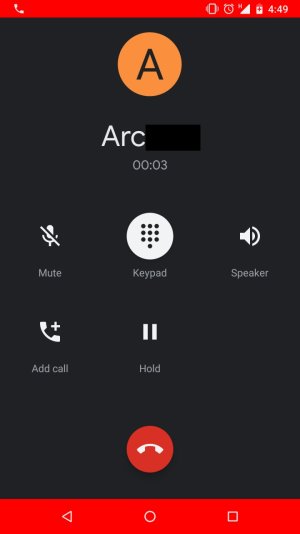

Hi,
I'm experiencing the same issue even though I've never had this problem before..
Tried with:
- wipe cache partition
- clear cache of the Phone app
- force stop the Phone app
- reboot multiple times
- power off, boot multiple times
- safe mode
but didn't solve the issue. The only thing I haven't tried yet, is to clear data of the Phone app.
Model: Nexus 5X
Android version: 8.1.0
Android security patch level: December 5, 2018
Phone app version: 42.0.284275632
Thank you!

Hi, welcome !
Try safe mode?
The screenshot shows that you're in Battery Saver mode. Not that this should logically be the reason, but what happens if you turn off Battery Saver?

Hi. I am UK based and having the same problem with Nexus 5x. Tried all steps including safe mode. Any other suggestions please. Spent 90 mins on it this morning. Thanks

Hi. I am UK based and having the same problem with Nexus 5x. Tried safe mode and I believe all of steps above with exception of 'Clear Data'. Did you find a solution??!!. Thanks

update
i managed to fix this by uninstalling update in phone app (poster in another forum suggested)
appears to be quite a few people with this same problem as of yesterday
