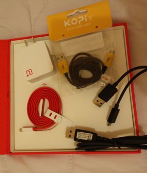

-Contestants: Motorola Moto X cable, OnePlus cable

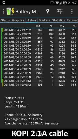

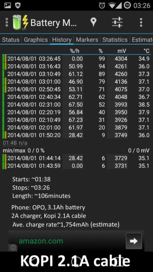

Kopi 2.1A 20AWG cable:
Average current: Trial 1: ~1,754mA per hour, Trial 2: ~1,690mA per hour
Total charging time (for 3,100mAh): Trial 1: ~106min, Trial 2: ~110min

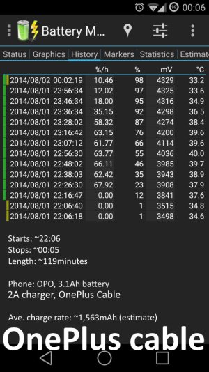

OnePlus cable:
Average current: ~1,563mA per hour
Total charging time (for 3,100mAh): ~119min

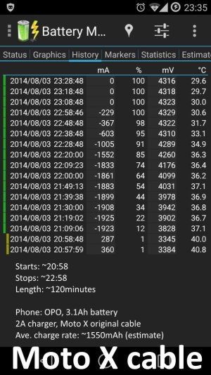

Moto X cable:
Average current: ~1,500mA per hour
Total charging time (for 3,100mAh): ~120min

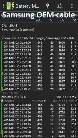

Samsung OEM cable
Average current: ~388mA per hour
Total charging time (for 3,100mAh): 7-8 hours? (!)
OnePlus cable:
Moto X cable:
Samsung OEM cable

The Moto X and OnePlus cables are also pretty good, and you're not missing out much if you don't want to shell out money for the Kopi. In contrast, the Samsung OEM cable is extremely slow, I actually gave up half way because it took so long. It truly highlight the difference between a quality cable vs cheap one. Even though it is a very short cable at 3ft couldn't help being extremely slow at charging, even connected to the 2A charger.
