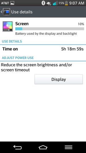

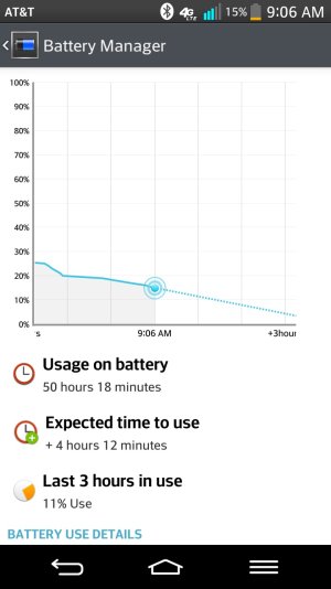

You certainly do not need to turn everything off on this phone to get amazing battery life. I do tend to be a battery hawk, and as such, I don't load my phone up with things or run features that I rarely use. Attached are screenshots of my most recent time off the charger, which definitely falls into the "light usage" category. However, even with light usage, I had a bit over 5 hours of screen on time over the course of 2 days off the charger.

The attached shots include pretty basic usage. A little bit of talk time, roughly 5 hours of web browsing, Tapatalk and texts, and about 4 hours of playing audio to my car via Bluetooth.
