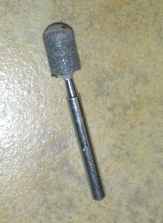

Some notes about the dremel. I used a small bit with a rounded top (see pic). This makes it easier to get into the corners. The plastic is soft and will grind very easily - I used about 40% spindle speed on the dremel. So just do a little at a time and keep testing it with your phone until it is right.
See attached photos for finished product and the dremel bit I used.
