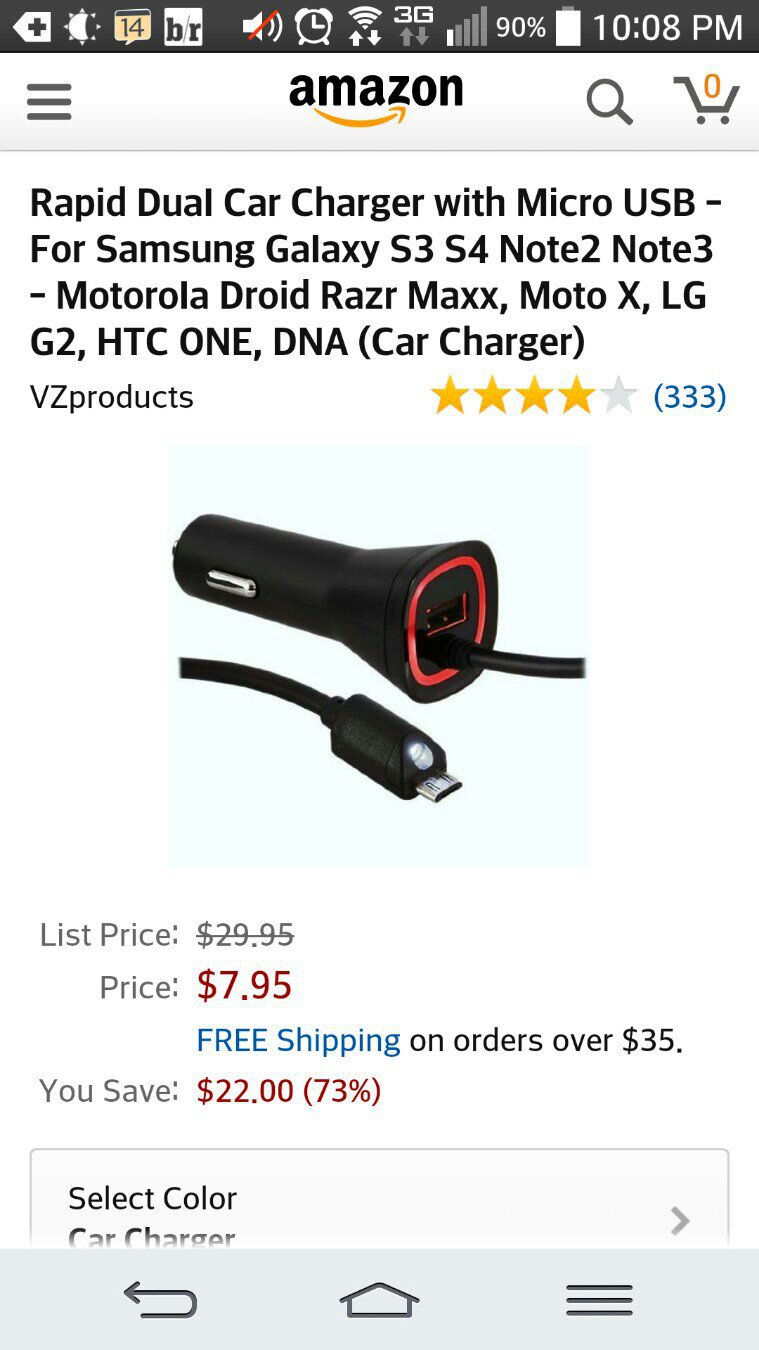

Verizon Dual USB Vehicle Charger - Verizon Wireless
Here's a screen shot of the One I got.

I have this as well and confirm it works terrifically. get this. it's an unbranded oem Verizon charger and charges at 1.5+ amps. there's even a bright white led on the end of the cable that turns on whenever the cable is moved. makes finding it and the port on the phone super easy.
