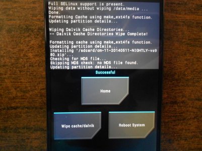

I am using a rooted verizon LG G2. I rooted the device with ioroot 25 and installed TWRP 2.7.0.0 using AutoRec. (AutoRec - KitKat Recovery Installer - xda-developers, Here's a forum if you're unfamiliar with AutoRec)
Whenever I try to flash Cyanogenmod 11, TWRP says the flash is successful. I then go to reboot the device and I'm stuck in a boot loop of LG's logo. During the flash, TWRP mentioned that no MD5 file was found, which may or may not be related to the issue I'm having. During the bootloop, I booted back into recovery using the keys on the back of the phone and restored Stock LG KitKat. I've tried using mulitple versions of CM 11, nightlies and snapshots. I'm stuck using TWRP 2.7.0.0 because AutoRec is one of the only methods I've had success with when installing a custom recovery.
I've seen LG G2s running CM 11, but I've had no such luck.
Any advice is appreciated.
