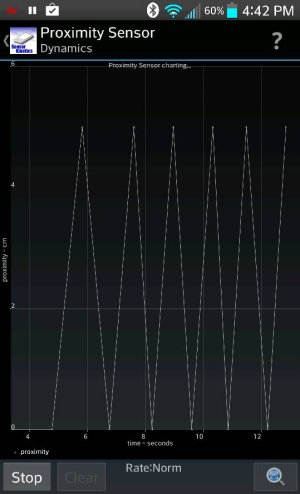

I have the same issue, a sensor test shows me that sometimes proximity sensor doesn't work, and sometimes works properly... I tried to recalibrate the sensor as suggested but doesn't work. I also tried an hard reset... no again. Do you suggests something else? Can it be an hardware problem?

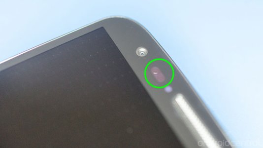

Hi there, i recently bought an LG G2 case from trident. and i keep hearin things that my screen protector is blocking the proximity sensor..can you tell me where it is? and i also heard if you cut the part out covering the proximity sensor . i can use the knock knock feature without any problems.
It is the little black oval sensor between the front camera and the speaker.
(in this photo you can see very well the front camera, a little bottom there is the proxymity/bright sensor)
