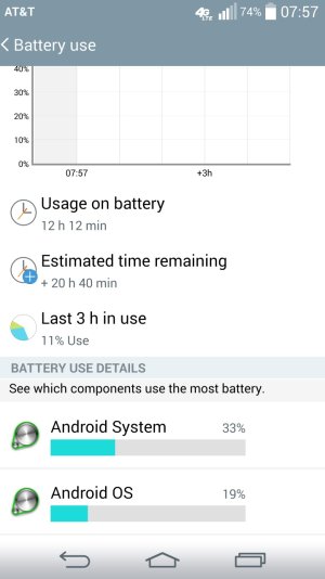

Unfortunately, Android System will mask a lot of what is really going on there. I take it you are unrooted. Much of that on the Android System screen is bloatware.
Your battery life really isnt bad. Try turning on WiFi. Another vital app I have been using is Autosync2 to disable Google's untimely syncing when I'm away from WiFi and a power source.

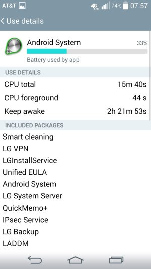

Everything that runs under android system is shown under "Included Packages"
I see you still have Carrier IQ (CIQ) installed, get rooted and get rid of that A.S.A.P.
Carrier IQ is the LADDM apk. That crap runs constantly.

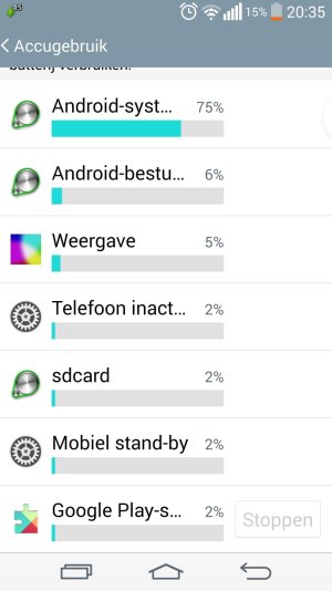

Het is toch niet normaal dat Android 75% van de batterij gebruikt (ook na installatie van de 2 apps) terwijl er niets met de telefoon gebeurd!
Helaas is dit voor mij niet de oplossing, Android blijft de batterij leeg zuigen.
Iemand nog andere ideeën?
