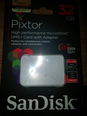

So yesterday I went to Best Buy and picked this up for $18.01 with tax, took 2 videos and several pictures last night and so far no issues. Hopefully the Micro SD card was my problem.
bar1203
Jan 28, 2011
74
Visit site
I only use sandisk! Bad experiences with other brands corrupting & losing everything on it.
